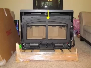

I just tried the dollar bill trick on my brand new unit and with a slight tug I'm able to pull the dollar bill out pretty easy where the arrow is. In addition, the door isn't exactly flush with the other door. I'd say by an eighth of an inch. Any suggestions?
Could be the dollar bill. Send it to me and I'll check it out...
Typically. Most stoves have an adjustment of some sort. Be the Handle or even the hinges themselves.
There's probably an adjustment. FWIW, the gaskets on my Keystone - Door and ash pan fell loose after the first few burns when the stove was brand new. I put some gasket glue on them, put the gasket back in place and so far so good. I probably ought to do a dollar bill test on both of my stoves for a pre-burning season check/prep.
Good luck,
Bill
The Declaration has big, wide doors. With the latch on the bottom of the doors, it wouldn't surprise me that it is harder to maintain tension in the middle-top. Hopefully we'll have an installer chime in here. If not, give your dealer a call for direction on how to make this adjustment correctly, if at all.
