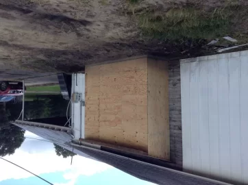

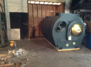

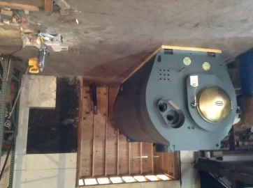

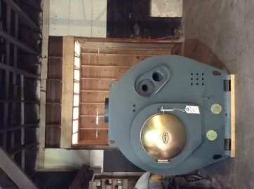

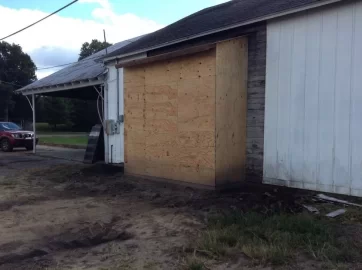

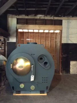

Hello everyone,
Finally getting around to the installation. We bumped out the wall behind the unit to facilitate plumbing connections, and that moved the front of the unit back about 18" which was a better spot. Unit is in it's final position on the thermal foam. We buried 95' of Thermopex to our shop which is the second building that we will heat. Each building will have water to air HX and air handler setup. Will try to post as things progress.![Garn install phase 1 Garn install phase 1](https://www.hearth.com/talk/data/attachments/138/138438-d05a5eb56da7edf857257654360351f7.jpg)
