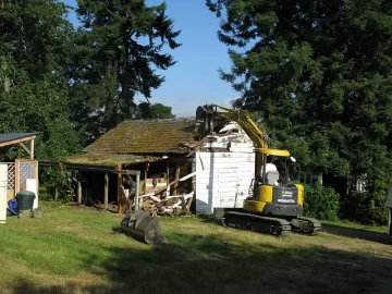

Update: The old garage came down this morning like a house of cards. New building going up soon.

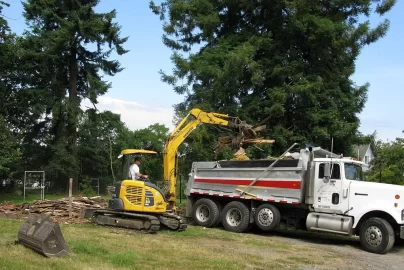

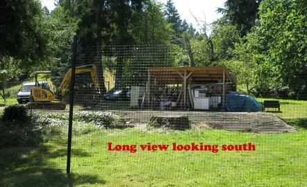

Yes, I was surprised at how quickly it was being hauled off. The site was cleared by 1pm, screened gravel should be arriving soon.
Here's a little sped up video of the excavator at work. The grace and power of this machine in the hands of a good operator is amazing.

Man oh man, that operator knew his stuff. Picked that garage down like he was using his own hands on a model on his kitchen table.
You will enjoy the new building. Everything works, nothing leaks, much more space. Whats not to like (cost aside).
I had never seen one in action until we built a house for some local folks back in 2010.
The guy (who, with my assistance, also did the foundation and block work) was taking whole sections of roof and walls down and stacking them.
He was digging footings by mid-afternoon. Very cool machine.
I want one.;)
I'm still surprised sometimes with the damage I can do with my little backhoe. :-)

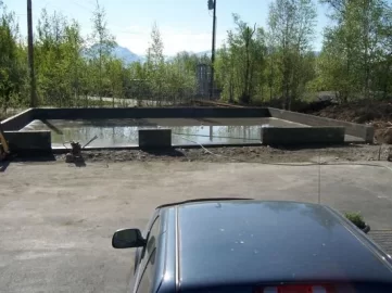

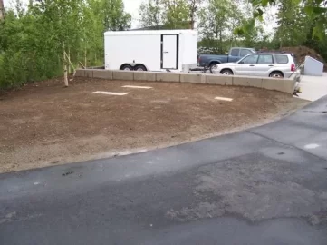

Yes, it was fun to watch. The main benefit I hope will be a rodent free space. The old garage was a rat hotel. The bill for this is jumping up quickly. In order to provide a level base one corner had to be built up 30"! I came home from work and found this huge plinth built for the garage. Now it looks like we are going to have to add a retaining wall on two sides of this base, sigh.That's going to be costly.
Why not backfill and grade to a taper. Might be cheaper than a wall?
Looking good be-g.

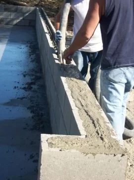

When I built mine, I did a 4" monolithic slab & 2' high block (8") wall all the way around. Then I backfilled with a slope away from the wall for the water to drain out & away from the foundation.
Rain gutters help too. Under ground 4" pipe for the gutter down spout to carry the water well away from the foundation.
With the 2' concrete block wall , no worries about hurting them on the inside, Works great for a shop/garage, I seem to bang into them now & then with stuff & it just bounces off, no damage to the wall. Was some added expense, but should last forever & not require any repairs.
I did 10' walls on the main shop, the extra height is nice for shelves & ceiling clearance.
Just some ideas. Wish I would have run an air line from one side to the other & the plastic electrical conduit under the floor to each wall from the breaker box, cheaper than wire, would've saved wire & plumbing & out of the way, Don't forget a few AC outlets in the ceiling. ;)
