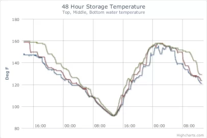

Wow nice how fast this group cut to the matter. I had to chuckle as I read that the orlan would only get to 145 I thought BEEN THERE BAD WOOD. The only way my eko 60 will ever run that way is when the gas in the tank is weak. As to the water to air exhangers they work well for me with low temps. I run all the way down to 85 before they are not usable, They deliver air 15 degrees cooler than the water as a rough rule in my house. You just need to get used to the ever increasing run time of the furnace until it's on non-stop when your tank is "out".
  • [Hearth.com] Frustrated with my Orlan 60...any one wanna buy it?!  Or help me?!  Long read...sorry.  Just.Need.He
mwk . . . how hot it your boiler to get the tank to 160 °F ?
The boiler runs at about 170 for most of the heating and starts to climb when the bottom water starts heating up. At then end it runs at 195 IF I have a good load of wood. Usually it is trailing off and I don't want to reload since it is early in the morning and the trade off is not good for a few degrees more.
I simply shift to starting the fire every night at about the 110 mark during the cold months. This gives me my 70 degrees and I get about 170 ish in the tank by morning. Factoring in the time to get up to temp for the cold boiler and the heat load from the house. Works good and does not stress my EDPM rubber tank.
Edit : The boiler will read 194 but the actual water feed is 184, I hate that about the eko. I have an in line temp and a sensor that both say about 10 sometimes 15 less than the eko built in sensor.
