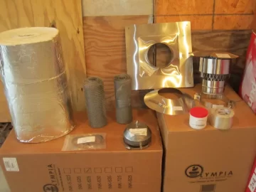

Received material. Having trouble adding additional photos

1. Instructions say leave insulation 6" below crown allowing for expansion. Existing clay liner cut flush with crown. Is there that much expansion and do you cover that exposed insulation edge with anything? Seems something should go there to help weatherproof.

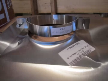

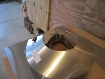

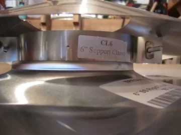

2. Instructions say cut liner 4" above crown. Silicone crown and install top plate. Then install top support clamp pushing against top plate. Then install storm collar. My top plate has a raised center section rising about 1-1 1/2" above rest of top plate. With support clamp in place, the storm collar will not drop and touch top plate even if you clip the square corners of the clamp. Do I have the wrong top plate and should it be flat? If the top edge of the storm collar is sealed with silicone onto the liner per instructions, does it move with the expansion and contraction of liner? What am I missing? Concerned about weather tight install.

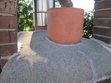

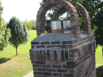

It would help to see the top of the chimney. Can you post a picture of it?
The storm collar doesn't need to touch the top plate. Some liner installs don't even have one.
begreen:
Here are two photos

If the storm collar does not touch the top plate, what keeps water from entering where the liner /insulation come through the existing clay tile liner?
It is my understanding that there is not silicone around where the SS liner comes through the top plate right at the existing crown. What am I missing?
the instructions sound right to me. The top edge of the insulation should be taped with foil tape. then the stainless mesh over that. The top plate should have a flange sticking up that will keep water out no silicone there. Then the top clamp and then the storm collar
Exactly right and this top plate isn't flat. It's sloped away from liner opening and has what looks to be a 1/2" collar flange too.
