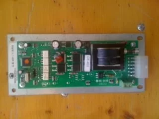

I have a circa 2001 BW-P2000 insert and the power went out at my house so I fired up the generator. (Somehow the generator surged and blew out my pellet stove, dishwasher ceiling fan and regular heating system.) I am now in fixing mode and have pulled the P2000 insert out and tried fixing in with no luck. Below is what I have done so far.
1) Changed fuse in back of circuit board - plugged back in and it blows immediately.
2) Pulled of auger motor tested w/ direct power from a pigtail. - Auger motor working fine.
3) Disconnected blower / fan / heating element etc. - plugged in board and it still blew the fuse?
Does this mean for certain the board is blown? I was thinking of testing the blower motor, heating element / fan one by one but not sure if I can put direct power to them and don't want to ruin any more parts.
Any help is much appreciated. FYI - before this power surge the stove was working fine.
Thanks
Eric
