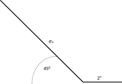

Mine measures 6" wide x 24 3/4" long with about 2" left for the flat mounting to the top of the insert.
