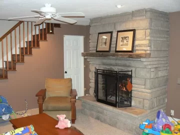

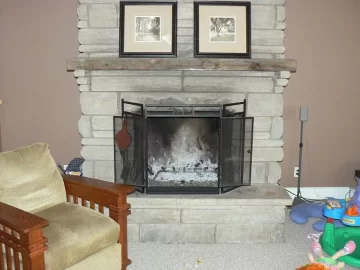

Not quite a first timer, but the extent of my indoor wood burning experience has been this season's burning in my masonry fireplace. Basically, I've had just enough time to realize that my back is going to give out from cutting and splitting wood before I get anywhere near heating my house with the fireplace. I didn't think it would be efficient, but man. This thing eats wood. Here is my situation.
Approx. 2400sf house. Masonry fireplace (33" wide x 26" deep x 25" tall, 16" hearth and about 15" up off of the floor). The fireplace is located on the wall of a 25x25 family room/addition. The rest of the downstairs contains a fairly open dining room (open to the living room) then a doorway to a kitchen, den, hall and bath. The open stairway is almost right next to the fireplace. Up the stairs and you've got two bedrooms above the living room, then down a hall to two more bedrooms and a bath.
My goal is to heat as much of the house as I can with wood, without completely burning us out of the living room. I've got two furnaces (don't ask why) that run on LP for backup, but at over $3.00 a gallon I don't want to have to run them any more than necessary. Easy, right? Throw in a big bad insert and be done with it. Unfortunately, the wife can't stand them. I got her settled on a Morsoe 5660 insert (I think that's it - the big one) since they look pretty slick, only to find that it will take some serious modifications to the fireplace to get it to fit. No dice. The Jotuls look pretty nice, but seem a bit undersized for my application. So - two questions:
1) Any other thoughts on inserts along the lines of the Morsoe and Jotul stuff? Clean, simple, and as flush as possible would be the look, but my personal criteria are a good sized firebox and at least a shot at heating the better part of 1800-2000 sf.
2) What about sticking a wood stove in there? I've seen some darn good looking stoves that fit all of my criteria, but they're stoves. I've lurked here long enough to be familiar with the idea that inserts came about after folks started sticking stoves in their fireplaces, and wanted to make them better, but them why do I still see photos of folks with new stoves stuck in their fireplaces? The look is OK in the wife's eyes, and with something to seal up the damper space it seems like they ought to be efficient. Can I do this with a flex liner? Is there any reason NOT to stick a stove in my fireplace?
I'm fairly ignorant about this stuff, but eager to learn, so feel free to educate me. All suggestions are welcome. Thanks in advance!
Nick
(oh - I can provide photos of the fireplace if it helps)
