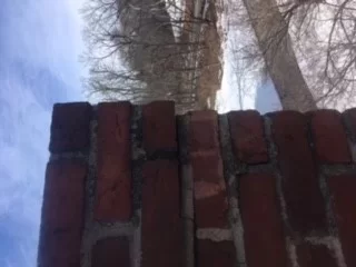

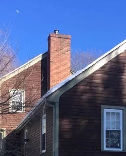

Chimney is about two stories in length, and 40% is outside. I did notice the top of my chimmney had some cracks for the mortar falling out in one small area.

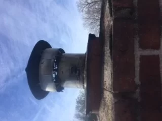

The top is close up of my cap? Other than some of Creosote, what do you think of this type of Cap?(I was recommended this isn't a good one).

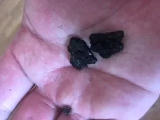

I wasn't able to get it off, I did unscrew one of the bolts, but it was still tight, and to be honest wasnt 100% sure the proper to take cap off so I will do some research. it did look there must have been creosote up there, but did appear to cleaned from the sweep. There was a little soot, and creosoate that must of came out during the sweep. Maybe 1/4 cup. following is pic. It was soft like, and moldable. I couldnt see in 100% but looked simillar to what the bottom looked liked after cleaning, I could be wrong.
