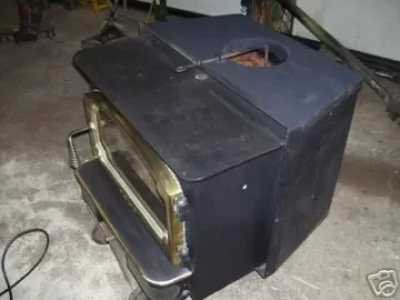

I purchased a used Lopi Flex/95 insert on Ebay. Stove was made in 1991. Model no longer made. It looks great, just need info on how to best install. Can anyone copy me an owners manual or install guide for my stove. I will be glad to pay. I have sent Travis Industries 2 emails and I get answers like ask your local Lopi sales rep. We do not have one here. The stove has 8" round flue connect, has cat converter that looks in good condition, my chimney has an 11" square clay liner in great shape. I will have to remove my damper in fireplace to get pipe up from stove to beginning of liner. Should I go that route and use a block off plate or should I purchase an 8" flue liner? I am a novice a would thank you for any advice you could give. I have found links on the net to install instructions of the newer Lopi inserts but not this one. You can see pictures of the stove on Ebay as auction # 220198050672,
did I make a mistake buying such an old stove? Thanks for taking the time to answer. [email protected]

Thanks Craig! Very useful information. One more opinion of yours please, in looking at the picture I posted, at the to of the stove where the flue connects do you see the rod across the top that works the damper? It looks like I will have to cut a slot in the pipe I connect there before it will fit. What will keep smoke from coming out into my living space from that point? Thanks
I've done that slot thing many a time - no problem. Any holes in a venting system should suck IN, not let smoke out. Consider it like the hose of a vaccum cleaner, if you make a hole it will not let anything out.
That said, make the slot only as big as needed - no bigger.
