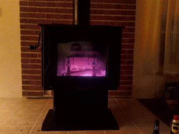

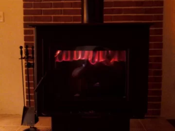

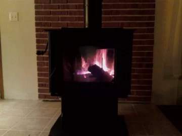

Check out that last picture. Thats so cool when a stove burns like that. It did this for twenty min or so. Man, this stove is so much nicer than the old Englander 12 I had

No comparison to a Pellet Stove.Check out that last picture. Thats so cool when a stove burns like that. It did this for twenty min or so
