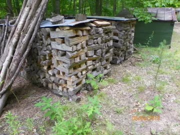

In addition, when splitting wood I like to split a lot so that we end up with rectangles and/or squares. Looking at the picture below, notice the ends are built with squares and rectangles. We really like these for that bottom rear. Most times we will have very few coals under that piece and will have it tight to the rear of the stove. We do this even when the weather is not so cold, like lows maybe in the 20's. Usually with those temperatures we do not necessarily fill the stove but it will give plenty of heat so that we wake up to a house that is still in the high 70's. Then we add wood and get the temperature to around 80. Plenty of folks winch at those temperatures but this is how we keep our home all winter long.
