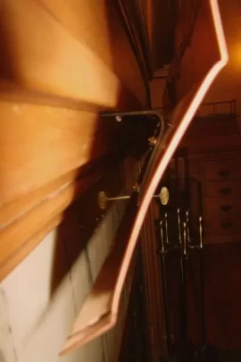

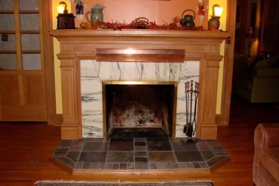

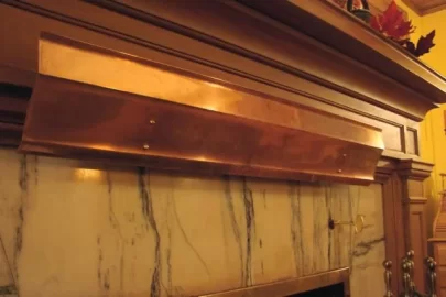

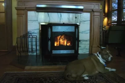

I was in a somewhat similar situation. With their rear heat shield you have to maintain a minimum of 18 inches clearance from any face trim and 30 inches from any combustible material that is directly overhead. I ended up putting mine about 8 3/8" outside the opening and fabricating a copper heat shield to protect some of the face trim. This also necessitated building a hearth pad that was about 36" deep.
You probably don't want it inside the box, unless you have a walk-in firebox.

This guy has to be a member here. He has almost the same copper heat shield for the mantle as you.
Yes, he is. He's posted that video here before. He and I PM'd about clearances just before he added the heat shield. And we exchanged posts about hearth pads as I was laying mine out. It's funny, we both arrived at very similar conclusions independently.
It appears, to my eye anyway, that the cleearance is the same between the top and the sides of the stove and the mantel. Why is the heat shield only necessary at the top? Thanks for all your great replies, I'm working up the courage to call Woodstock.
I'd have to double-check, but I think if you're using their rear heat shield the clearance to the vertical face trim (on the sides) can be as little as 12 inches, whereas the overhead must be 18".
