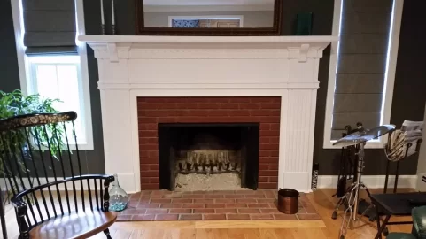

I settled on the regency i3100 to fit in my 40" x 28" opening. The room is 15' x 44' and has two doors that open to the main body off the house which totals 2500 square feet. Wifey likes the regency i2600 as she wants a flush look. I don't want an unproven unit, don't want a catalytic converter, and I'm resisting flush mount as they don't push out as much heat it seems. I like the ~20" log size and ~3 cubic feet fire box. I may have to use some kind of shield as the height from the 24" deep hearth to first combustible top trim is 38".
I'm on very thin ice........might be living in my new woodshed soon.........stalemated.
Any suggestions what might look good and function like the i3100 here:

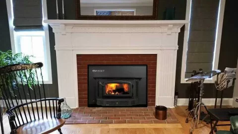

The Regency I3100 would look something like this:

Clydesdale - makes good heat, 2.3 ft box, soapstone lined, Largest viewing window on market, 22 inch log length, cast iron construction very attractive look, no cat, comes with ventilator fan and the fan is very quiet on low. I have 2 and have not turned on my furnace yet. currently in the thirtees here. House is a balmy 82 degrees. Two level ranch house 3200 square feet.

Nice hearth.
My 3100 sticks out about 5 inches. Not sure if there would be much of a difference between that and a flush unit for radiating heat. A lot of heat comes off the glass of mine, and I assume most other units do as well.
It looks like you have an external chimney. I'm sure everyone on here will mention insulating the back of the fireplace and installing a block off plate. After doing that with mine this year I have noticed a big difference in the heat that radiates off the unit. Sometimes I keep the blower off when it's too hot in the room, and it still puts out a lot of heat, and I credit that to the insulation.

My installer did not mention insulating behind the fireplace and a block off plate. He did say that plate is put at the top of the chimney which will keep the flue warmer and will draw better. Looks like I should inquire as to insulation behind the unit ...... thank you for your input.

My installer also did not mention insulating the firebox and said I did not need a block off plate because the top was sealed. That seems to be the case with a lot of installers after reading on this forum. As installed last year it did a good job of heating the home, but after doing this myself I can honestly say the difference in heat output is significant. There are numerous threads here for info on insulating and block off plates if you want to read up.

Most installers are going to take the fastest way to install. With an exterior chimney a block-off plate will keep more heat around the insert cabinet and thus you'll get more heat out of it. It will cost a bit more which may be why the installer is balking. Ask him to break that out as a line item in your quote, then just do it.

Thank you BeGreen...is this a special type of insulation? I can have it on hand and install it...
The insulation is Roxul mineral wool, available at most big box stores like Home Depot. But it should have a metal retaining plate below it. Here is a description. At the end of the article there are several links illustrating installation options.
https://www.hearth.com/talk/wiki/why-damper-seal-is-needed/
