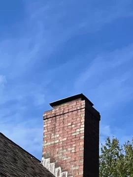

Attaching photos. It starts with a three-foot rise to a 90 degree into the stainless-steel liner T, then straight up. So, two 90 degree turns then roughly 25-30 feet up and out. Liner is in the house until the very end. There is a cap with a spark arrestor (also pictured). Blaze King has been very responsive in helping me try and figure things out. Here is what I already know from them:
  • That first 90-degree elbow should be two 45s instead
  • The spark arrestor can be finicky, but the installer assured me it was clear.
I’m working on getting the two above items addressed.
My draft appears to be ok. Obviously, this is per the installer. But with the door cracked and how dry the wood is it lights up very fast.

I'm gonna question your wood. That wood looks very fresh to me. 17% could be 20 -21% if you sink the meter pins in deeply. But that should burn better than you have described.
You must 100% rule out the wood....... as what you described is, in 95% of the cases, a not seasoned enough wood situation.
If wood is indeed very good, Then i'd be thinking blockage of either intake air or exhaust. That spark arrestor could be hindering the flow, we can't see it in the pic. Also as others said confirming the thermostat is working properly is called for. Then there are the oddball things like packing materials left somewhere in the stove or birds nests, bugs, crimped pipe, etc. in the liner.
