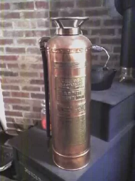

Just get yourself one of these bad boys...
Seriously though. Being on a well I keep several around the house. One small one in both kitchens next to stove. Bigger one by the wood stove. I've actually been thinking of a full size unit (the size of the antique in the pic) to keep on hand.
