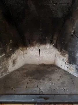

Hello all! I purchased a Harman Accentra 52i and it needs another inch or so for back corners. Curious if we can grind a few firebricks to facilitate a flush mount without altering front fireplace facade. Our fireplace is in a wedge shape so plenty of depth just a bit shy for width. Will this jeapordise integrity of fireplace?

Depends on how much you grind off
Probably not but I am not an engineer and have no idea
how the fire place is put together . For myself I would cut them
so I could get my insert installed
Would cutting a 1-2" chunk out of both sides approx 24" up be too much?
I would check with a professional. I think the last thing you want to do is compromise the integrity of the fire brick both for your future use or the next owner of your house.
You cut too much out, you will have to use a zc box and hard pipe it. What’s behind the brick?
