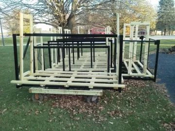

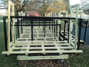

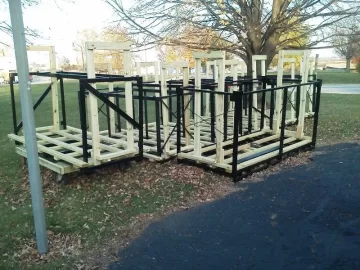

Finally got these finished up to store next years wood supply. I am tired of stacking, loading, and restacking my wood in the garage. The plan is to load these and leave them to season outside. Once needed I will just pull the whole bunk into the garage with rolling cart I built and my garden tractor.
The metal frames were salvaged as is from a local implement dealer's shipping crates, I painted them up with implement enamel, and then built the wood floors and sides. I got seven of them built this year. They are a little over 7' long, about 40" wide, and 5' tall racks. Enough to hold approximately 0.9 cord cutting my normal 18-20" firewood.
They vary somewhat depending on what equipment was in them. I left the bracing bars in them in order to keep the strength and in order to go higher up with the wooden sides.
Hopefully they will work well and I should be finding out pretty quick. Total cost was under $400 for everything.

One question though, when you roll the cart under the full rack of wood how will you lower rack onto roller?

I am going to be using cement blocks or 6 x 6 wood blocks about a foot long under all 4 corners of the bunks while they are in storage. This will keep the metal off the ground and allow more air circulation underneath. When it comes time to use the cart I will temporarily raise each end of the bunk using my automotive floor jack and add more blocking to just clear the cart. There are metal feet on each corner of the frame that I will put the blocking under. I will probably raise each end up a couple inches at a time until the proper height is reached vs raising it all at once. When the cart is in place each end will be lowered back onto the cart.
I just started loading one bunk today on the cart for a test run. Since it was a test I purposely loaded one side of the bunk to over 4 feet and left the opposite side completely empty. The balance is good and with it half full I can still move it by hand. Probably will get much harder when full but overall it seems to be working fine. I will post the results, good or bad.

The racks are designed for a fork lift, not sure if a pallet jack will go under them with the bracing but I am going to check that out. Thanks.
My dad has a Kubota tractor with a bucket, he will probably let me borrow it to move the racks once and a while. Only thing is I would have to go get it. I think I can fit four in the garage at one time so most of the winter will be covered with one move.
