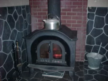

I finally was able to get a pic loaded up of the stove in question

sir I have to ask. who would buy an unlisted stove, without the slightest clue in what they are buying?
with out a listing or any kind of identification, no building inspector would ever issue a premit to install it
In the past I remember seeing a stove like that made by Scandia
hopefully some can identify that stove then we can try to find if it was listed
Rut Roh. Not only does the stove appear to be unlisted, but that install looks unsafe to me. Combustibles way too close for that stove. The floor (which looks like vinyl, or even if it is wood) does certainly not look safe. Also, if the floor is in 12x12 squares, that would mean the stove looks to be about 8" to the rear wall.
I would find out if the stove is listed, and if it's not, then attempt to return the stove and get my money back. Regardless, I would definately install whatever stove you choose SAFELY.
Bucko64, please understand we are not trying to be jerks here, just concerned about the legality and the safety of you and your family.

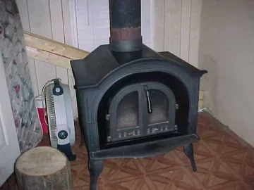

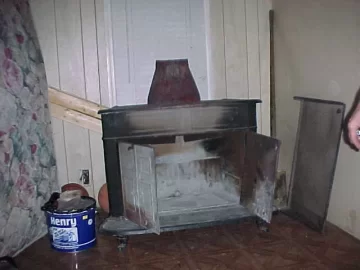

Ok guys it took a while to get the camera to work but got them.Hear are pictures of the dead dragon and the new install.Actually i did not install the old set up and glad i didn't There was a used pice of fire back on the floor. He used the pice that had the hole cut for damper,big brown char spot on the rug... I liked to shoot..Any way this setup is ten times better Im SURE.

Bucko64, what's the clearance to the wall and the back side of the stove? Also, what's the clearance of the single wall stove up going up? Does it go into a thimble or straight up?
I think that's an old Franklin stove (your old one)???
Have you determined what is the brand/maker of the new stove?
-Kevin
Man, that's one scary old stove. Forced a friend if Fair Oaks, CA. to rip one of those out 10 years ago. Those things freak me out.
New stove looks good. Did you get the make model and vintage yet?
Wrech the stove is 15'' from each wall cemt board with ceramic spacers them fire board . Stacck is double insulated 2 foot down from cealing.Much better then what was there and how they had it. They had nothing but panneling on the left side,Hole in fire board underneath ETC.
UncleRich thanks I didn't get make or model yet I know the front is cast and the box is steel
