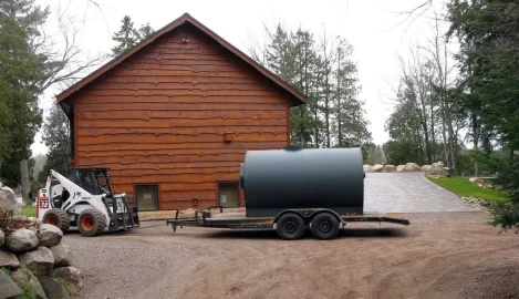

After a year and some delaying health issues/summer landscaping projects, I am finally able to install my Garn.
I have placed the Garn under the overhang and am ready to start enclosing the outside walls to make working on the Garn enclosure more comfortable.
I posted my photos at http://mygarnadventure.blogspot.com/ .
More to come once the installation is underway.

Great pics George! Man I wish my overhang was 2 feet wider. You did a nice job on yours. I had to thread a needle with mine, and my thread weighed nearly 2 tons! :lol:
Keep the pics and updates coming.
Congrats, nice setup, will be great once it's finished.

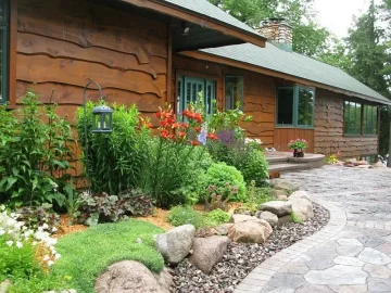

Nice work on the boiler but I gotta say that live-edge siding (and fascia!) looks mighty handsome all varnished. I've done enough brightwork on wooden boats to appreciate the job you've done there.

George,
Congratulations! Now the real fun begins. We have been online now since Wednesday, and so far so good. You won't be disappointed when you finally get to light you first fire. Good luck, and keep the blog updated, love to see the pics!
Thanks Dave, my wife and I have built the house from trees we harvested form the woodlot and sawed on our sawmill. It has been a long project which I look forward to finishing. Attached is a shot of the siding at the entrance on the lakeside. The finish is Sikkens. We used 110 gallons total for the house and workshop. It is a three coat process, first coat all sides.

Bravo on the Garn (and the house); also looked at your wood-turnings on your blog photo site, and _wow_!
Hey George,
Good luck with the Garn.
You can't beat the look of the live edge siding. As a retired sawyer, I think it looks great and I like what you did with the fascia boards.
