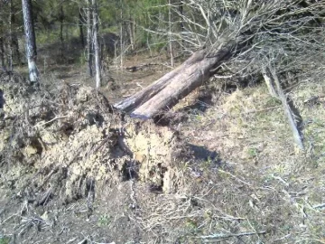

Cut off the stump a few inches past the rootball,but do an undercut first,then uppercut about 1/2" over from it so bar wont pinch & it will drop free. Make next cut a few inches below first branch,using same procedure.Mill the log with Alaskan mill or bandsaw into thick planks or square posts.Cut up remainder of tree & other scrub for fuel.
Hard to tell from that picture how stable that root is, but with some windfalls like that you have to be prepared for root-ball to flop over.
Somebody posted a story a while back about some guy cutting a windfall tree and his young son was playing under the root area and got crushed when his dad cut through the trunk of the tree and the root released and flopped over.
Very carefully! Might want to try giving a push with loader and or with a line tied to trunk the higher the better to see if it settles in. I cut one much like this and when it let go I found myself six foot away on my back , tossed the saw away but things went soo fast no time to react. Moved each arm then each leg found things working and got up O.K. this time lucky. There is a lot of stored energy
there just be careful I cant tell cus not there but I'm sure you can study it just be careful
Can you cut the root ball off, then hook the trunk to the truck and pull the tree out until it hits the ground...? Just make sure you've got plenty of chain length so your truck doesn't become the next thing holding the tree up.
No, I can't get a truck or any other equipment near that root ball, except 90 degrees to the lay of the trunk. Even then I've got about zero pulling distance.
You said no room to pull with the truck, and can't get a loader near it - how about a winch? You might be able to use a snatch block to compensate for the 90 degree angle.
Yup. I'd cut the root off first but I wouldn't think any wedges would be needed (Whoops. Sorry Jay, but I know you like the wedges.). Be sure to undercut it first. The rest should be a piece of cake.
Always carry two bars. Unbolt the power head and slap the extra B & C on and cut the first one loose.
Cutting that root ball away, I would use wedges. If the ball stand up, you won't need them, but if stays where it lays, the trunk portion of that tree is gonna stay real close (and probably move towards) the roots. Without the wedges, you will be stuck (if the ball stays down).
