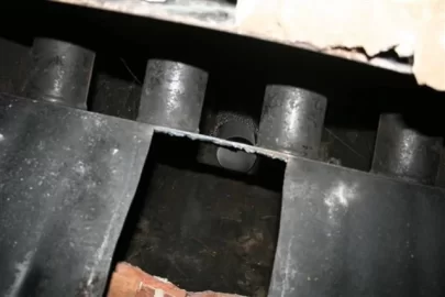

Chimney lining: I installed a rigid 6" Heatfab 304 stainless liner with insulation in our 25' tall, 12"x12" tile-lined stone chimney. I worked from the roof and had to install in 3 sections; 2 from the top joined as it was lowered in, and 1 from the bottom using a "slip connector" pipe. The last section at the bottom is an adjustable elbow that enters the stove from the top. There is not enough room for a tee at the back of the stove. Ease of flue cleaning was an issue for me so I considered other options since I had no tee (more later on that). I bought lining supplies from Hart's Hearth. They were were knowledgeable, fast, and great to deal with. I highly recommend them. (see photos)
Fireplace modifications: since the existing fireplace was a prefab built into masonry (no combustibles nearby) I modified the Heatform to allow the flue to exit the top of the stove. This involved a cutting torch, lots of cussing, and a bit of masonry work. I also had to modify the fireplace's masonry arch a bit to allow the stove to fit. I installed a 4" outside air supply in what was the ash clean out at the rear of the fireplace. I filled with masonry what was the fresh air supply at the front of the fireplace. I also built and installed a blockoff plate and an OAK adapter for the 3" air inlet at the bottom of the stove. (see photos)

1492 - original flue showing heat exchanger tubes and the hole I cut for the new liner pipe.
