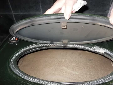

Twist the tabs in next time tighten down and you wont lose them, although I don't know why I would ever need them

Ive had my top oval bolts out sense AI bought the stove. Absolutly no problem what so ever

Thanks for the photo CP. Also, thanks Hanko for your confirmation that there is absolutely no problem.
I decided that I would turn the tabs in as well when I do my annual inspection. Just checked the oval, and what-do-you-know, it was floating and I had already turned the tabs in. So I did burn last winter with the oval plate floating. Ditto to Hanko - absolutely no problem.
I do keep a hydrator pot and trivet on top of the oval plate. But when the stove is operating, it is under negative pressure. So I can't see a scenario where the oval is going to pop up.
