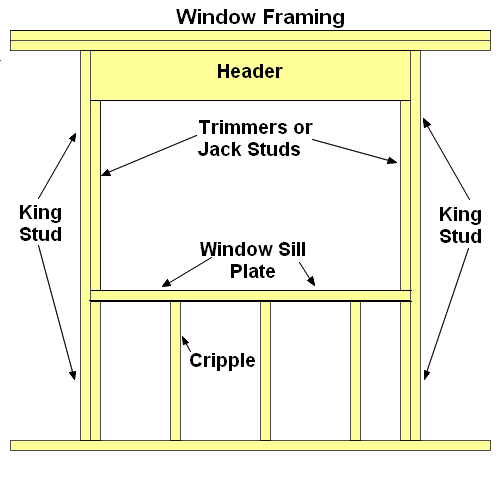

Jackstuds and double 2x with filler up top out is not hard to do. Make sure they do it right.
It should look like what you would do for a "window"
