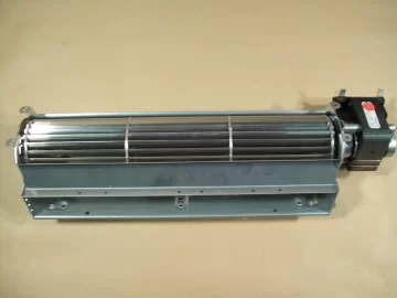

This one may Fit . do a little more investigation
it 273 cfm
http://www.ebay.com/itm/181834044920?rmvSB=true
This one does fit but only 135 cfm

The link you posted above is for an insert model. Fr model uses this style Enviro Empress FS Potential Convection Blower Upgrade
