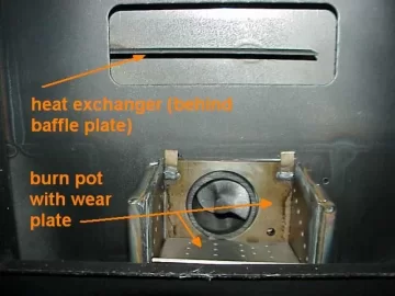

I tried to find a photo of exactly what I'm talking about but failed. It's the area behind the baffle plate, the heat exhangers. I found this photo on the Englander site. It's different from my stove but if you picture the opening in the back wall as being half this length, and the "shelf" being at the bottom of the opening rather than centered in the opening then you pretty much have what my stove looks like. There is no room to get anything larger than a drinking straw through the opening below the self so you have to snake the hose over to the right, down, then back to the left in order to clean ash from below the shelf. It's no problem to get a hose to go over and down but the turn is sharp and short enough that it just hits the bottom of the chamber and won't make the turn back to the left.
I know I'll explain this poorly but......the straight run you have to make to the right to get to the downward opening is longer than the downward section and there's another horizontal shelf about 4 inches above that one so the only kind of curve I can put in a hose is a very sharp hook right at the end. If I manage to get that into the lower area then the end of it is pointing straight up, towards the bottom of the shelf and it doesn't get the ash that's laying on the floor of that section. (Turning the vac on just causes it to suck onto the bottom of the shelf. :grrr: )
