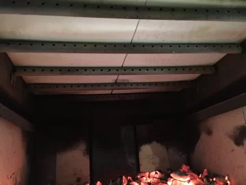

Was able to get a pic of the secondary burners this morning.
[Hearth.com] Englander 32NC - over fire at 650?
Reactions: Highbeam
Video of the stove burning. Fully shutdown, secondaries are firing. ST temp is 500, flue probe is 700. It feels like the temps are holding, actually dropping very slowly and under control. Definitely throwing nice amount of heat.
