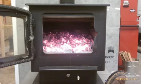

So first, you need to be sure of what ESW told you. There is the big round hole in the back that is the primary air intake. Right above that hole is a rectangular cutout that is the air supply for the tubes that make up the secondary combustion system. I think they wanted you to block that swqaure one off by 1/3 but do you know? Finally, for the sake of completeness, under the stove in the front two corners are 1/2" holes that both feed the doghouse air inlet. Blocking any and all of those holes is fair game if you feel like the stove is running away on you.
When you inadvertently get it hotter than you would like and you quickly close down the intake rod, the other air inlets will increase air flow into the firebox to relieve the vacuum and cleanly combust the offgassing fuel. It might look like shutting the air control made it worse for a little while but just wait for things to settle. Maybe a few minutes before temps start to react to shutting the air on a ripping non-cat.
I've actually melted the air wash plate on mine by leaving the throttle at 100% for too long when starting a fresh fire. No big deal. I now start the stove at 100% throttle but then back down to 75% or so as soon as possible, then let it warm up to 600 or so before sliding the rod in farther to my cruise setting that tops out in the 700 range. Some folks like you with very strong draft might be closing things down even sooner to maintain control. That is easier than trying to recover and wastes less fuel too!

OP, what is the measurement from the bottom of the stove to the top? I wasn't sure if the advertised height included the flue connector
@Highbeam & @Seasoned Oak , does your stove keep a steady, forceful stream of air through the dog house at all times?
It sure looks like it does. The wood load always gets a hole cut through it right in front of the doghouse hole. The side wood is the last to burn. I don't know if that is due to the doghouse air or the airwash air that rolls down the center of the glass but whatever. The doghouse air is fed by two external holes in the stove body, full throttle all the time.
This stove is rated to burn very clean and for a large stove that isn't common. Especially a cheap and large stove. Things like the doghouse air keep the temps hot which keep emissions low.

Wanted to report back. After reading the advice from other threads, I added a thin piece of aluminum tape across the secondary air supply at the back of the stove. Blocked about 1/4 to 1/3 of the opening and it has made the stove very controllable now!
Before doing this I couldn't achieve the "lazy flame" it just roared all the time. So, at least in my case, I've determined that the dog house isn't the problem. It's honestly nice to have it stoking the coals with steady air. The unrestricted secondary air was just too much and after this little modification it works perfectly now.
