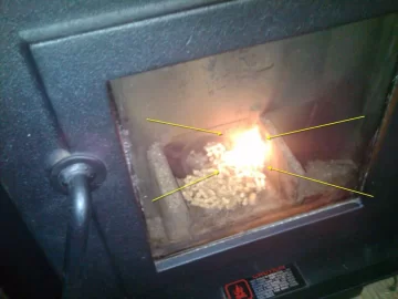

Anyway, the results from steps 1 & 2 are in. Good news it fired up at 42 Deg F in the shed!
However it took 11 mins, not under 10 mins like a GOOD normal firing. Will it fire at 20 Deg F? Not Sure? ? ? Possible CSS - Cold Start in Shed issue if it does not fire in time for the Thermal Sensor? ? ?
I probably cannot test that until next year, but I encourge You and your company to do that testing for people who buy them for cabins and retreat properties where it is very common to go in at 0 - 20 Deg F and fire up a stove.
If your stoves do that and you advertise they do, then you have Danson and Pelpro Ind in Canada beat by a mile!
Still getting a new ignitor but all set for the rest of this year, See yellow arrow in pics below.
I pulled the blue tube off the ignitor tube and plugged it with a screw. Then I pulled the ignitor out MORE so it protrudes beyound the back of the igniter tube as shown in the pic below!
BTW I just painted the door, Makes it look like new. Stove Bright Satin Black matches perfectly! Is that what you use?

Don,
If that tube the air hose was attached can be removed you just might get a faster start up.
Don,
Good idea Smokey but it seems to be tapped in there solid. Drilling a couple 1/8th holes in the collar is still a better idea. The collar can be replaced easily if it gets messed up. The best part about this is that the two holes in the back will make the air travel the full length of the igniter!
I would try the 2 holes. Quite a few cartridge ignitors use those holes.... I bought my buddy an ignitor for his Baby Countryside and it had those 2 holes Mike mentioned to try. [Hearth.com] Englander 25-PDV E2 error Start Failure but works the 2nd time!
