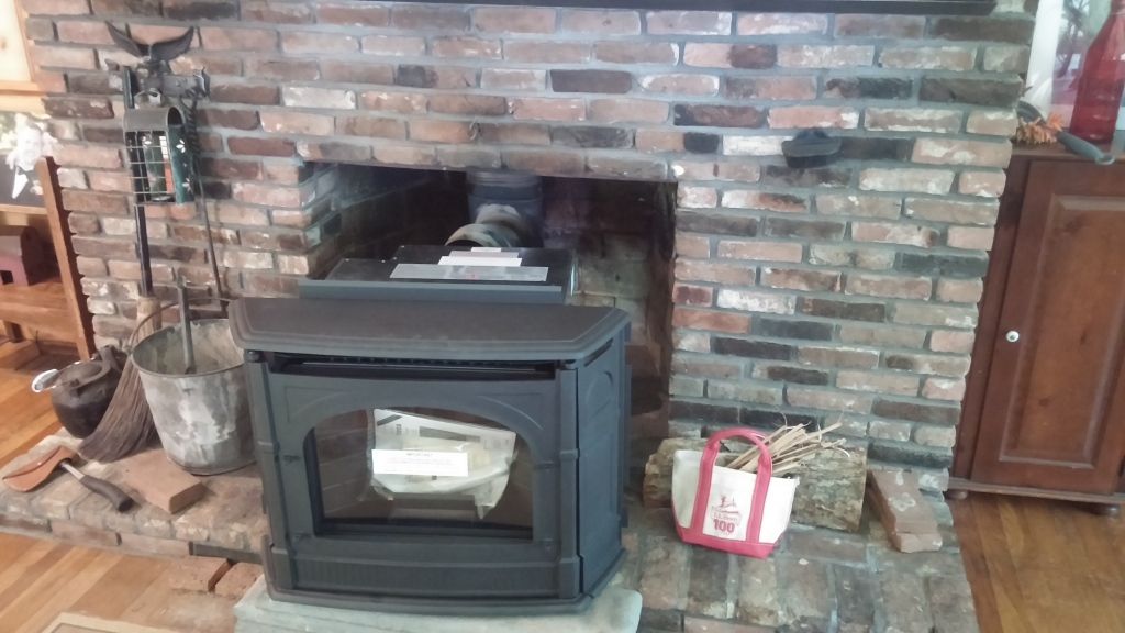

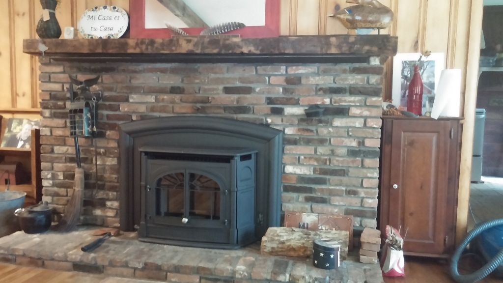

Very nice. Did they install a fresh air pipe?

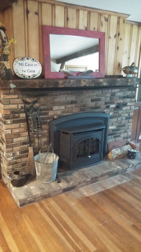

nice new stove! OAK is always good at your not using the air that is warm in the house to go up chimney. You have a small stove but it would not hurt. I would to a test burn when you can have all the doors an windows open as it may stink for the 1-2 hours. In the summer with doors open will not be a big deal. congrats !!
Looks great, now fire it up. Nothing lonelier than a dormant stove!
Installer telling you that an OAK is not needed just shows he don't care. It will save you 5% fuel if nothing else. Go for the heated intake style (if possible) which is even better.

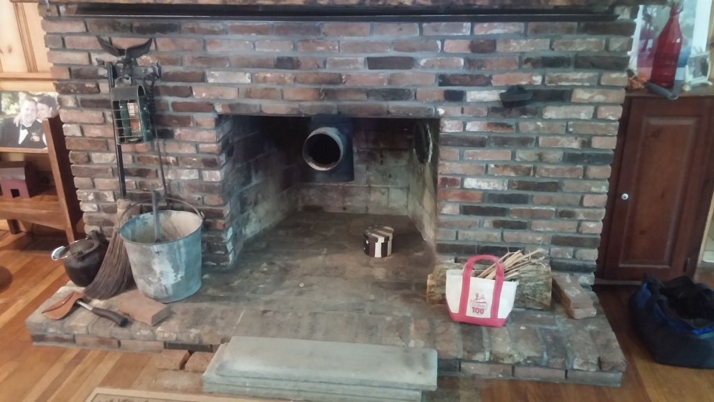

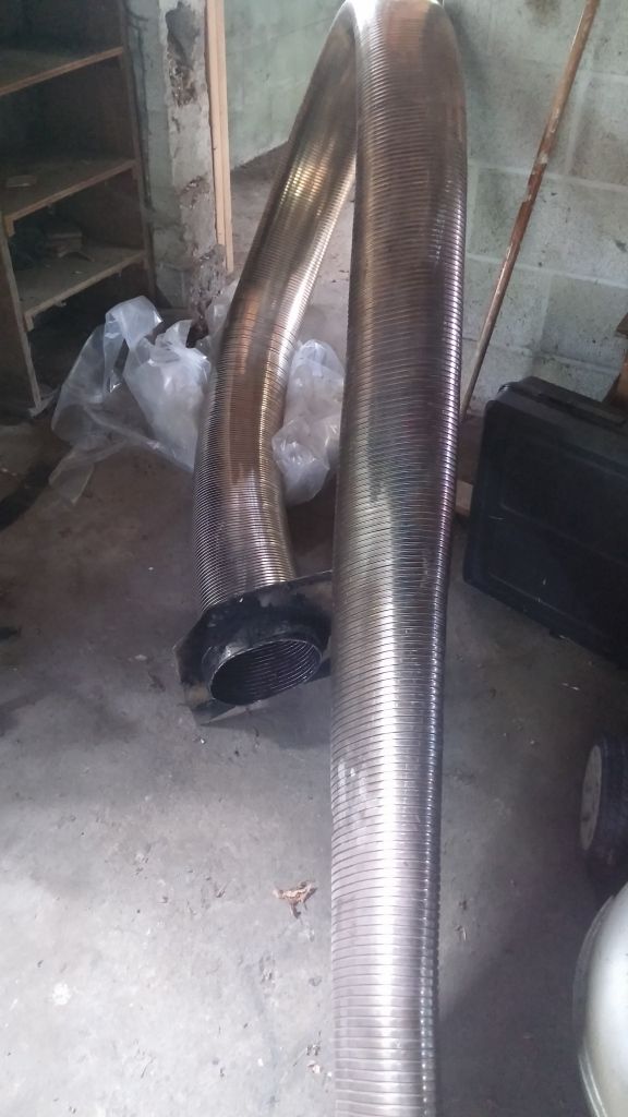

Great idea but in a fireplace install often the outer flue skin ends inside the house or just above the smoke shelf block off plate if used and a single wall liner is run up the chimney. That's how mine is anyway. 23 ft of single wall liner inside a masonry chimney.Easy and super effective, just use the outer flue skin as the intake, if you can.
Have a look at our attached install instructions for how we do it and I am sure you can work something similar out for little expense. Even if you just drill a few air holes in the top of the flue air will come down unless it is packed with insulation or something.
I see. Do you think that this type intake alters the distance to the point of condensation by lowering stack temp? Thus lowering the position up the flue of condensation.I had assumed that as the stove was in the middle if the room it probably had an exposed flue to the ceiling.
It still works in this kind of chimney you describe provided you can draw air down the outer flue. You only need about a foot of heated pipe to make a difference to the intake air temp. We have a few installs like this and it works fine.
Even if the outer flue ends in the house it is worth harvesting the waste heat in the flue to improve the fire performance.
WE try and take the waste heat right up to the point of condensation. That is where you are pushing it too far.
