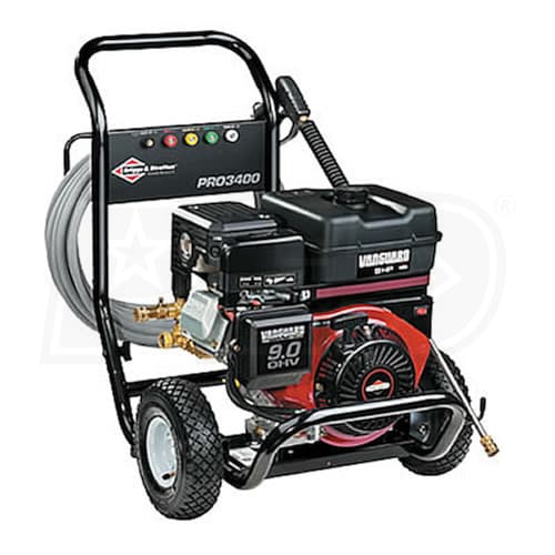

I will copy/paste below what I just wrote to a co-worker who asked me for advice on a pressure washer for her husband. I just bought a new one last summer. Here's what I bought. Rated at 4.0GPM and 4,000 psi....actually does 4.2GPM @4,400 with a 4.0 nozzle @ 0°. I have a set of larger 5.5 nozzles I can run with it to change the GPM/pressure. I also don't run it full throttle unless I really need the pressure/GPM.
[Hearth.com] Electric power washer? [Hearth.com] Electric power washer?
I also have one of these, which I picked up for $50. I called AR pumps and they sent me a new set of valves and seals for it no charge. It runs great and puts out rated pressure and then some (I also have a gauge on that one).
