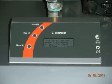

As I have to work full time, I do not have the time to constantly tweak the boiler for maxium efficancy, I am very happy with the Effecta, as I can load and leave. Being a negative pressure setup, there is minimal smoke when you open the door, The oxygen sensor is what allows me to load and leave, this keeps around a set percent of co2 and automatically adjusts the top and bottom dampers depending on type of wood, Moisture content of wood etc. I have been dealing with Brian @ Up North Energey and he has been great, helping out where ever needed, " tying into my existing gas boiler, and dhw".

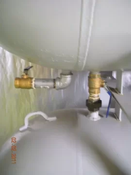

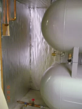

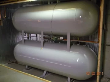

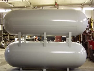

Fabrication of tanks before final move

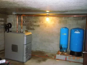

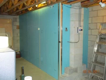

Boiler and pressure tanks in place
