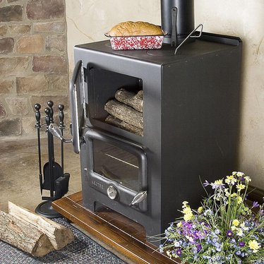

Whoa, hold up, I thought the OP was looking at the Drolet OUTBACK which is a more traditional looking wood burning cookstove. Not a plate stove with an oven on top/bad Vermont Bun Baker copy. If you want a vertical cook stove, there are better options that put the oven below the firebox. It's an odd design, but it works very well for places with limited floor space and will give you a cook top that can actually boil water. That oven top won't crest 500 df with the hottest fire, but any good wood burning range oven will have a cooktop that will go to at least 800 df, which is what you need to really cook.
That being said, unless you really like to bake and cook, a wood burning cookstove is an expensive heater. I personally bake a lot of stuff from scratch; pies, bread, quick breads, cakes, meats, etc. and use the cooktop regularly. We also make coffee with a French press, so it's nice to have a place to keep our coffee warm.
(broken link removed to https://www.drolet.ca/en/products/cook-stove/outback-chef-wood-burning-cook-stove/)
The VT bun baker has spots to cook on the top.
