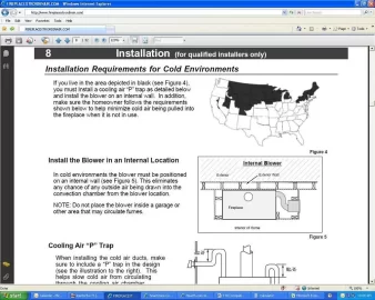

A few years back when we had ours put in the installer said that we needed to find a place inside to mount the blower. This really tweaked me since I had already cut and framed a square in the side of the house where I wanted the blower installed! I believe the most recent FPX install manual has a map that shows where they don't recommend using posi-pressure.....I can't remember if it was recommended for IL or not.

I pull in outside air, the pos pressure is good for me as I do have drafts that I am slowly working at improving. I have not noticed any issues with the P trap.
Here is an excerpt from the install manual.....you guys in the white are lucky!
Y

I do have an furnace and a water heater down there but my basement in just shy of 2000 sqft with 9ft ceiling. i don't believe this should be an issue.
I am in the white. But I am sw of Chicago and I don't care what the map says it's cold here sometimes
