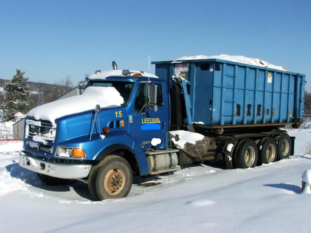

Geez, Lee, that thing must hold a whole cord.
Cord and a half, if you heap it up.
6 cord in that box. Have bigger boxes that hold 8 but I don't like running them cuz it puts me right at 13'6" and if wood is over the top theres a good chance of catching a wire .
Legal for 79,000 in NYS and 119,000 with the pup trailer.
