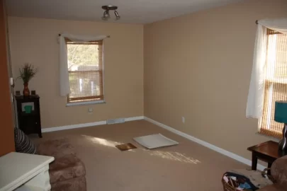

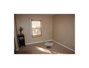

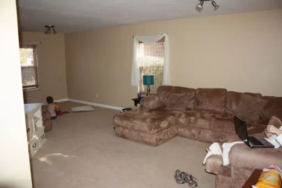

Finally, we need some advice on placement. We have a corner wall, in which we can run the pipe straight up. The problem is it soo close to the window. The other spot is more towards the middle of the wall, but a second story window forces us to move the pipe using a 45 degree bend. I will attach some pictures of where we are considering it. The big white square represents the size of the woodburner.
