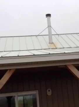

Discolored Metal Roofing
The BlazeKing is cruising on "2" and I measured the flue temperature right above the stove collar at 289 and 115 at the ceiling collar (6' higher). Seems like a lot of temperature drop in that single wall pipe. Could this be my problem?

Looks like rust to me. Once the metal is cut, especially steel, it will rust, especially under the silicone.

Rust. My friend has that same roof on his building, and it was installed poorly. I'll help him change out the gasketed screws every now and then, we can always find the ones that leak by following the rust trail running down the roof. Every now and then we'll have a new screw that leaks, Can usually find it because it will have the rust trail after one rain.
Whoever installed your Chimney without flashing and weatherproofing it should be smacked around with that Dektite when you get it! And the excuse of "they'll always leak" is either laziness, or lack of skills.
I would still like it if you could post a close up (clear) picture of that roof penetration area and the "rust".

It's covered with ice and snow at the moment :) I did have some slightly discolored icicles hanging from the cap this morning (we had freezing rain and snow last night) so I ran the stove on high to take the stove pipe temps up. Seems to have cleared the ice.
Rust won't discolor icicles , you are not burning hot enough . Even seasoned wood (20 % moisture or less ) will still cause creosote at low temps . Surface temp of your black pipe should be minimum of 250F.
I'm burning Hedge so burning hot is not the challenge. The flue temperatures at the collar are hot but they quickly cool in the single wall pipe when measured just before the ceiling collar. Anyone know how much difference I should see if I replace the single wall with double wall?
OK, If your burning hot enough , then you need that heat all the way up the pipe . Where ever it cools , you will get creosote condensing on the pipe and it will drip.

You may not want to hear this, but even if you are burning proper wood and have those other issues fixed a light colored roof is a bad choice for a wood burner. The flue cap is always going to catch any un burnt material in small quantities and it gets deflected down onto the roof. In my opinion you can minimize it, but there will always be some residue seen on that white roof. I have to ask, did you pick a white roof, or was it there when you bought the house? I don't see many white steel roofs at all.

That creosote is corrosive, if he doesn't clean that up and do something to prevent it from continuing to happen, it will end up corroding the metal surface and "rusting".

Well that brings us back to the wood maybe, or just normal condensation and dripping for winter time.

As begreen said, it is likely creosote dripping of your chimney pipe.
This can happen if you are burning wet wood, burning your fires too cool, or if it is cold and windy outside and the wind cools your chimney cap enough that the smoke condenses on it and drips off.
It is certainly not an ideal thing. If it continues it will stain your roof much worse and the creosote is corrosive and could eventually eat the finish off your metal roofing.
Make sure your wood is as dry as possible, and try to burn as cleanly as possible.

It might just be condensation which is dripping off the cap to the roof. Nothing you can really do about that.
White roof while good for reflecting sun & heat, is not the best choice of color.
White anything on a house, never stays white.
The flashing is your main issue, or lack thereof actually.
I don't think there will be a simple solution to the stained roof.
In a few years a white roof would be green on the north side of the house out here. Moss grows in the darndest locations.
jhambley, I would start with changing out to double-wall pipe to fall better inline with the mfg. recommendations.

Honestly, I was thinking it may have bee just that . . . condensation dripping from the cap since it seems like it is just a bit discolored.
