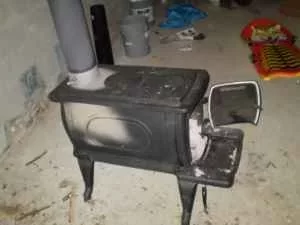

This stove showed up on a CT craigslist today. It's a good example of serious overfiring and what you don't want to see in a stove.
The dude had the temerity to end his ad with " my loss, your gain." - right... lucky he didn't lose his house. Can you see your kids playing around this?
yeah... i'd say that was rode hard and put away wet. just a touch on the hot side
<chuckle> wonder what the inside looks like
The castings didn't shatter. ;-)
