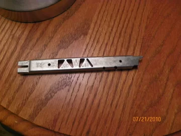

Purchased a couple of these to use cleaning out the bar groove on the stihl chainsaw, works great.

I have that one as well and a couple more, Just use the first one that comes up and thats the quickest one. Oh and use the air compresser keep that saw like you need to sell it...

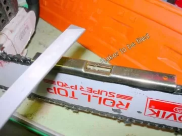

I bought that gauge but it doesn't come with instructions. How are you really supposed to use it? I was intending to knock down the rakers on my Stihl chains. Ended up just knocking a bit off of each one.
Whatever comes through the round whole need filed shouldn't be very much at all.
Highbeam found this on another site.
zap
  • Depth Gauge Tools
That's a different tool than the stihl one though. Is the "round" hole the one on the left side of the photo in this thread? How do you run a file over the tool without filing the tool down as well?
I do not leave it there I will put a couple stroks on it and check it again until its flush. I like the rakers to be round and sloping back.
