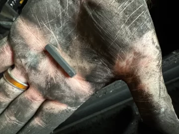

The air control handle on the dauntless has completely lost link with the door controlling the flow of air.
The stove was not over temped and has been treated very gently and it is only 2 years old.
Anyone have this issue before? I can’t find anything in the manual on how the air control lever actually is accessed or repaired.
This appears to be the right thread for this even though the above question was not answered.
My Dauntless was installed 3 years ago and always had a problem moving the lever for primary Air Control, but it operated.
Last winter it seized up, stuck open. Needless to say, I could only run it with a small load of wood.
Today, I removed the bolts on the inside of stove that holds the inner wall of the stove in place, behind which there is a cable mechanism.
The lever was stuck but when I removed the casing, and turned the lever, the item in the picture in my palm dropped to the floor.
The video (go to about 25 seconds) shows the cable action as I open/close the handle on the outside. Video is here:
https://photos.app.goo.gl/vjdH8zinp1UkiDtY7
How is this supposed to work? I assume the cable which is stuck against the outer housing must be re-routed towards the center of the stove,
What is the metal square shaped object that fell when I removed the inner housing to get at this? It is the pic in my hand.
I believe it to be key stock used in some way and when it fell, the outside lever handle would then move again (but not freely given the position of the cable). But it was no longer locked up.
Any explanations or pictures of a "correct one" would be ideal. Thanks

This piece of stock that fell out when I removed the internal cover to the cable assembly that operates the damper door.
Clearly shows a spot-weld joint on the center.
Now I need to determine precisely where it was and re-attach.
This video shows the assembly after re-assembling it such that the cable was not wedged into the channel.
Without the above stop in place, the lever can be pulled too far when opening and that pulls the cable such that it will wedge and then be completely "bound up" and the damper is stuck open. With a hot fire, there's nothing one can do at that point.
I don't see exactly where it would attach, as I don't see the remnants of a broken weld anywhere.
I've asked my dealer for help, this should be something that VC would have documentation on.
I also think it should be covered under warranty. There was no misuse.
The handle was always difficult to operate and I believe it was assembled out of tolerance at the factory.

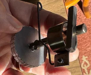

That looks like part of the thermostat. You can simply order a new one and install the entire piece instead of trying to fix it

Dealer is going to try to get the part (the whole assembly) under warranty. My stove is 3 years old and now a week out of warranty, but I'd reported this problem a year ago and also a month ago and supplied videos, pics, and asked questions.... So we will see if they hold up to their end (or respond at all). My dealer is not the issue here though at all.
I found your thread but doesn't look like there's pics of the thermostat assembly.
I did enjoy reading through it though. I've also learned about how this stove operates by disassembling most of it and am less confused on it's operation.
Part shipping to the dealer at the end of the month under warranty.
Not confident it will be the right part but not much I can do....
To complete this thought, I installed the warranty replacement assembly today. As i expected, the bar-stock piece is welded to the round shaft with a very weak spot weld. I'm not entirely sure of it's function to be honest. The replacement piece you can see the gear my thumb is touching does not fully engage into the slot that it should. I compared it to the old broken one and was able to fix it with a hammer. Yes, a hammer. This is by far the worse mechanical design I've ever seen on a production product. But this is what the assembly looks like before hammering!
