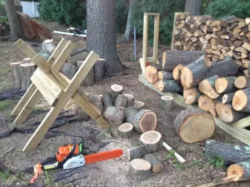

Built a sawbuck. Makes cutting so much better... and great on the back. Huge fan. Thx for the ideas to get me going on this.

Looks good and much easier on the back, plus lots safer than cutting on the ground and not worrying about kick back if you hit the nose of the saw.

Sawbuck is the way to go, sometimes I stack a bunch up and bungee them down.
Well done on the sawbuck.....if you keep getting oddball rounds from your buddy, it will get lots of use over the years....;)
