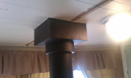

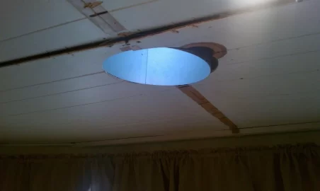

ok here we go, these are for everyone that was on me, i actually appreciate it. it made me get it done rite. the first pic with the round hole was where the stainless was coming into kitchen as you all seen before pics. and the second is almost finished.. i have to screw paneling back up and screw in the metal black finish pieces that came with it. i cut down on all four corners at top about an inch and folded metal out on to roof under the roof flashing and screwed it at ceiling level into ceiling rafters on all four sides.. just waiting on batteries on drill to recharge to put finish strips up. also getting ready to install the 3.5 inch flex tube for fresh air intake in a bit.. taking a break.. so can we now be friends!!! heheheh thanks again!
heres pics forgot to attach on last post

Excellent.
i had it 2 ft higher than anything 10 ft around it to begin with but i got an additional 18 to 24 inches of length by doing this and the draft is much much better now for some reason!
Cant wait to hear how it works when you get done, looking good though.

LOL, we kind of expected that. Good work Steve, this is way safer. You and we will sleep a lot better tonight. The intent of the double-wall with this stove is to keep the flue gases hotter. You don't need any more heat. But by keeping the flue gases hotter there is less opportunity for creosote to condense in the pipe. Burn dry wood and I think you are going to be seeing a lot less creosote.
A happy ending . . . just not that kind of happy ending. Looks good Steve.
