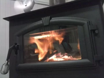

Well i managed to fit the new stove into the downstairs living area over the weekend. It was a tight fit as it is slightly taller than the old stove and it has a flue collar attached. The pipe comes through the wall at 45 degrees with not much flex but i got it all installed on Friday night.
The stove came in a plywood crate which i thought would be ideal for the first fire. I lit the fire with a few pieces of the plywood and off it went. The stove top zoomed up to 800 degrees within 1/2 hour with only a very small fire. the paint started to smoke and smell pretty bad but i managed to get it back under control.
The second fire started of OK with the pine kindling it easily gets up to 700-800 degrees then i have to close it down, then i load the hard wood but the fire has lost its momentum and nearly goes out.
The 3rd fire - started with pine got it very hot and then i place on the hard wood - once again the fire is smothered and i end up opening the door. When i open the door the fire really gets going quite quickly - does this mean that there isn't enough air entering the firebox?
The 4th fire - same as 3rd but i think the air enters the firebox through the the top of the glass therefore if i place wood at the bottom of the glass this will restrict the air flow. i ended up bringing the coals to the front and placed the wood to the back - this seemed to work better. I will have another go tonight when i get home.
The wood is not the best its been seasoning for over a year but another year and it will be good to go.
The stove id fitted with an outside air intake. with the fire located in the corner of the room there isn't enough air being drawn into the firebox? i thought about putting a fan nearby to see if this helps? is there a better way to load the fire once the kindling is going - without putting the fire out?
My main stove has no problem using the same wood - it burns 24/7 and has been for the last 3 months.
any suggestions?

You might try a top-down start. My stove loads E-W, so I put the bigger splits in the bottom/back, medium/small in front, and kindling in the top/front. If you're loading N-S (but it looks like it loads E-W,) just put the smaller stuff on top and put a little newspaper under the smallest kindling on the very top of the load. That will get plenty of air wash air and will get a hot fire going pretty quickly. The bigger splits that might have more moisture will have a chance to dry out a bit before the fire gets down to them.
Thanks for that - does this mean that the majority of the primary air comes from the air wash?
Sounds like you're almost there. Pulling the coal bed forward is the way to go. Put larger splits toward the back and some smaller stuff on the coal bed. Open the air up, let her rip until the wood is burning well and then start to dial down for an extended burn. Jotul has a pretty good video about this:

It's the wood. Several times each season we go through days of posts with folks and their first EPA stove thinking the air inlets are clogged or something. The pine tells the tale burning well. Too much moisture in the hardwood. Give it some more air and get over trying to "shut it down".
Pre-EPA stoves both had the air inlets shooting directly into the front of the load and not having to drag the air from the back through channels to the front. So they would burn a brick.
So really dry wood and not closing it down too soon are important.

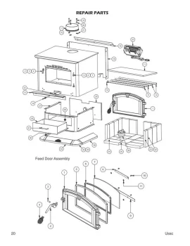

If the majority of air comes from the front though - that could be my issue as i have literally blocked it off by putting wood at he bottom of the door, which in my other EPA stove is not a problem as the air comes from the top.

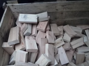

The pine is not in log form but from a roof truss manufacturer - its moisture is super low i can run them together to achieve my objective. how hot is too hot to run your stove? once it gets above 700 (stove top) i start panicking.......

i only put 4 pieces in - its from a roof truss factory round the corner from work. I can get as much as i want and its really come in handy with the new stove. I could split it smaller but that defeats the object of getting easy stuff.
