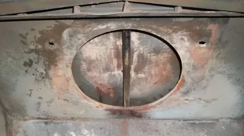

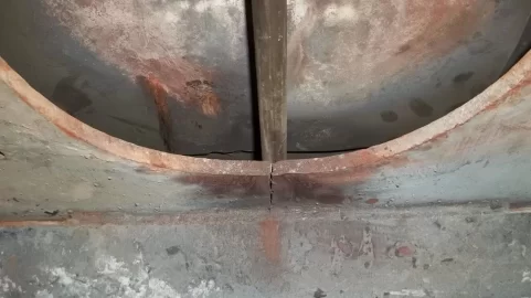

While cleaning the Cat holder portion in the stove, I noticed there's a crack so I'll need to address that. The chimney sweep came out today and all is well.
Here's a pic of the crack. What type of gasket material should I use between the cat holder and the stove, it had one when I started the clean up process.

How about Interam Gasket material? This is used around some combustors?
You need to drill a hole at the end of that crack so it stops spreading, really you need to weld it since it is steel. For temporary you could use some furnace cement on it but really it needs to be welded.
Yes, get some gasket wrap: (broken link removed)
The problem I have is the crack runs into the horizontal piece and I can't see past that. I'll drill at the end that I can see and weld.

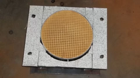

Well, I installed the new combustor and gasket today. I'll post the YouTube video of the burn after it loads.
