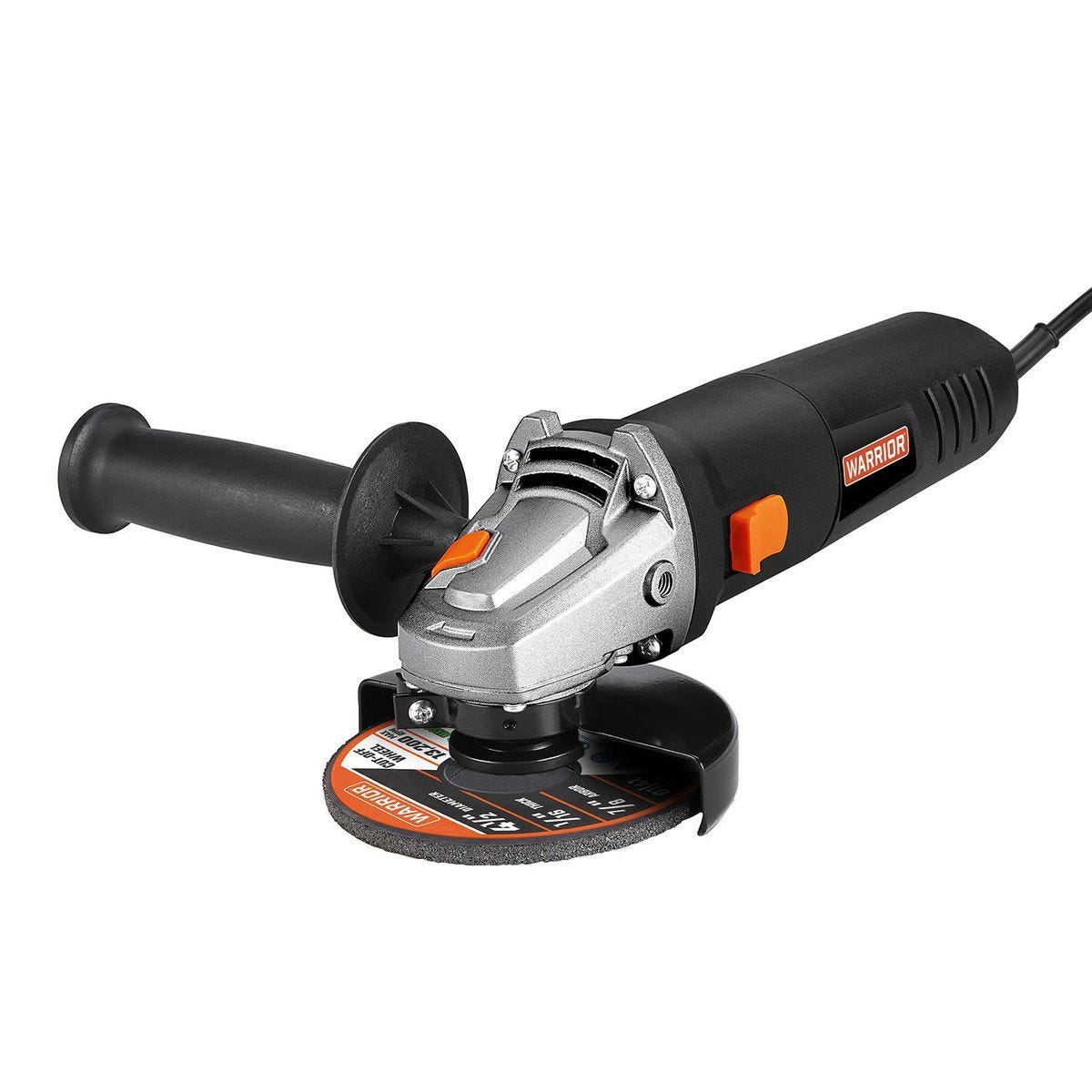

You mean they’re a standard size, right? There are several odd size cut bricks. I’m not sure I have the tools to cut firebrick. The oem part number bricks I’ve found are $24 per each individual brick 😳 or $400 for a set. There is a “cut pieces only” part number but I didn’t have any luck finding it anywhere.
Link to parts list/diagram:
I bet those are standard firebricks. They can be found at concrete brickyards cheap. A quick search shows them at Home Depot and tractor Supply too.
I’ve used tile saws to cut them and angle grinders. I bet you can pick up an angle grinder cheap at Harbor Freight.
