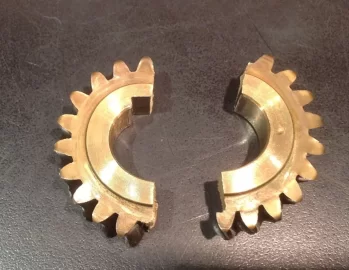

I'm replacing the whole gearbox, at a cost of $300. This was in my snowblower- I sucked up a big flat rock evenly with both augers, which jammed both sleeves against the auger drive shaft so that the shear pins didn't pop. The snowblower is 10 yrs old, but it's an Ariens and has never given me a lick of trouble- I think I'll get another 10 out of it with this fix.the gear is probably designed to be the weak link, now getting it apart to change it is another story. soaking, heat and pin punch as stated above. Mke sure it is a straight sided pin not tapered, which means it will only come out from one side, not likely but possible.

And, yeah, your gear looks broken.
