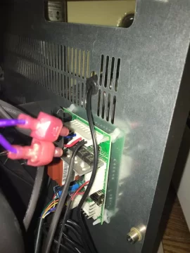

Do you have a voltmeter?
Yes. I have a voltmeter. Just bought one Sorry for not knowing. When you ask about how many fuses. Do you mean how many things are plugged in? Attaching a pic. Thank you for your patience.

It sounds like a control panel issue. You could run it directly to power until you get it resolved.
