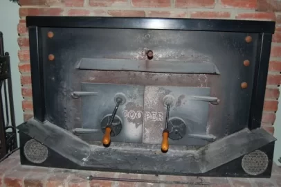

Any info about a COOPER fireplace insert. I'm looking for parts. Also, we've tried everything to
adjust it to get maximum heating and it just won't work like everyone
we've talked to said it would. We use a combo of oak/sweet gum/hickory
and some pecan. I've searched the internet, far and wide, and cannot
find anything about this insert. From what we were told when we bought
the house is that it was installed in 1977. Thank you! Will email pics of it if you would like.

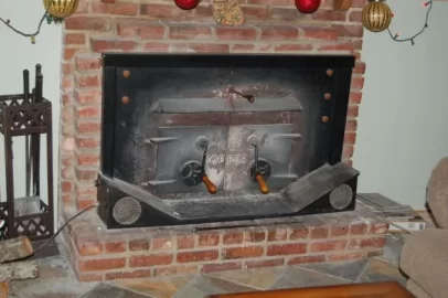

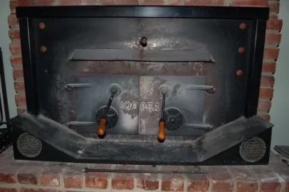

Here ya go! Thanks for answering me back. I was getting worried!

I thought about replacing this one, but it has so much character. It's the reason why we bought the house! We knew we were going to buy it no matter what the inside looked like because of the Cooper insert. We've been here a year now. Moved from Kissimmee, FL to Louisville, GA and we're loving it. It's hubby's home town. Population 2600. We are restoring our 1941 Craftsman Style House. I'm pretty much looking for advice on how open or closed the dampers on the front should be and also, how far closed should the internal damper damper go? I've had two fireman,(25 years who is also the City of Louisville's Gas Man & 15 years respectively), look at it. They both gave a clean bill of health! As far as parts... We're pretty sure we will have to either make them or have them custom made. My dad's a great welder and my husband can pretty much do anything.
Thanks inadvance for the input and future answers!
Linda
This is a "local" stove, that meaning one of hundreds of welding shops that started making stoves in the boom times of the late 70's- most closed within a few years. I have heard of just about every stoves....at least any that ever advertised or showed at a trade show - but I never heard of this insert! Can't tell you it is unsafe, but can tell you that a modern stove will burn much cleaner and therefore many less problem with creosote and smoke - and less wood use.
Sounds like you are attached to it - and after having left Kissimmee I can understand the desire to "get back to reality" - but at the same time, most of use here would probably scrap this thing soon.

Linda one of the first signs of overfiring is the pressense of a whitish surface Looking at that insert, the entire firebox is outlined in a whiter surface. When is the last time the chimney has been cleanned? How is it vented? Can we see the a picture of the fire box with the doors opened?
Looking at the pictures again that has been so overfired it has burned the high temp paint right off and bubled som of the remaining paint on the left side

By the appearance of the stove, is the chimney lined?/ block off plate installed?/ Is it clean???
Your treasure may cause you a few tense moments!!!!
