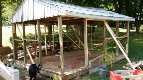

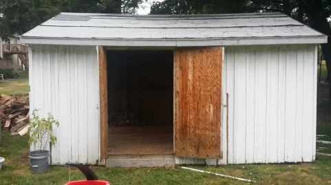

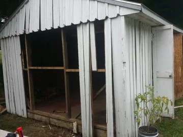

So yesterday I pulled the walls off this old shed out back. Changed out some of the rickety old frame work, Reinforced it.
Just have to re-roof
Not sure if I want to put slats all around or use lattice, any ideas?
Hope to hold at least 3 cord

The lattice will only be for looks. If you opt for slats it will provide some rigidity and sure up the structure. Just leave some gaps between the and you will be fine. Did you peak under the floor to see how the joist are? There will be close to 6,000lbs in there.....now is the time to sure up the footing and make sure the base is in good shape. You can't fix it after it's full of wood. Looking good so far.
Yes I'm going to take a peek on Wednesday, for nothing other than something crawled under there and died lol! Smells bad
Great. What's the dimensions?
12 ft sides, 16 ft front and back and about 8 ft high

You could hold twelve if you packed it floor to ceiling 12x16x8

I would add some diagonals between some of those posts to give the structure more stability. Also, I second the notion of making a careful evaluation regarding how much weight the existing floor can handle. Very few shed floor are constructed so that they can hold the type of weight firewood is going to produce. You can probably beef up the structural strength of the floor by strategically placing some cap blocks on the ground with cinder blocks or bricks with shims.
Good sound advice on the floor, I'd hate to have to tear it all up and see but I don't wanna have a floor collapse either
The floor is the only thing that's going to hold me up now. Which sucks because I wanna start stacking
