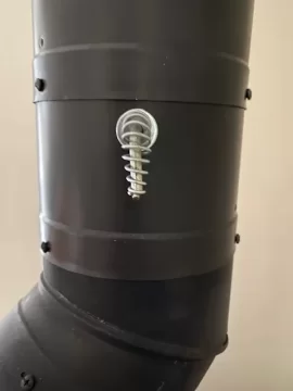

It's a common issue with modern stoves. Their adapter is a sloppy fit on many new stoves. Write them and tell them.
Some solutions are to wrap the crimped end with flat stove gasket, try an pound out the crimp to widen it, or don't use the adapter. I chose the last option by pulling out the damper assembly and reinstalling it in a straight section of pipe and gave away the adapter section.

I appreciate the info @begreen. I will let them know. And so for a double wall pipe, is the outer wall of the pipe overlapping the stove, so the gap between the crimped part and the outer wall is all on the inside? So it would look like this? And then it sounds like I can use furnace cement to seal that if necessary? I may do what you did and just remove the damper and drill the required holes in the stovepipe directly because the pipes do fit nicely on the stove as is.

I had to use a single wall double male to make the tight fit from stove collar to dvl adapter on my stove

It depends on the stove. If the inner crimped pipe fits snuggly into the flue collar, then nothing else needs to be done. If the inner pipe can't seal because of the outer pipe is snugging up too soon, then the outer pipe might need to be trimmed a little. Or, make an adapter out of a short piece of single-wall like kenny did.
OK gotcha sounds good, I just wanted to make sure I wasn't negating the benefit of the double wall with that air gap being basically open to the hot air from the stove, neither instruction manual got into that level of detail. But depending on exact height needed I may just remove the damper and put in the well fitting stove pipe. Thank you
